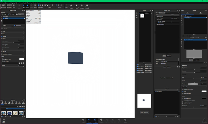

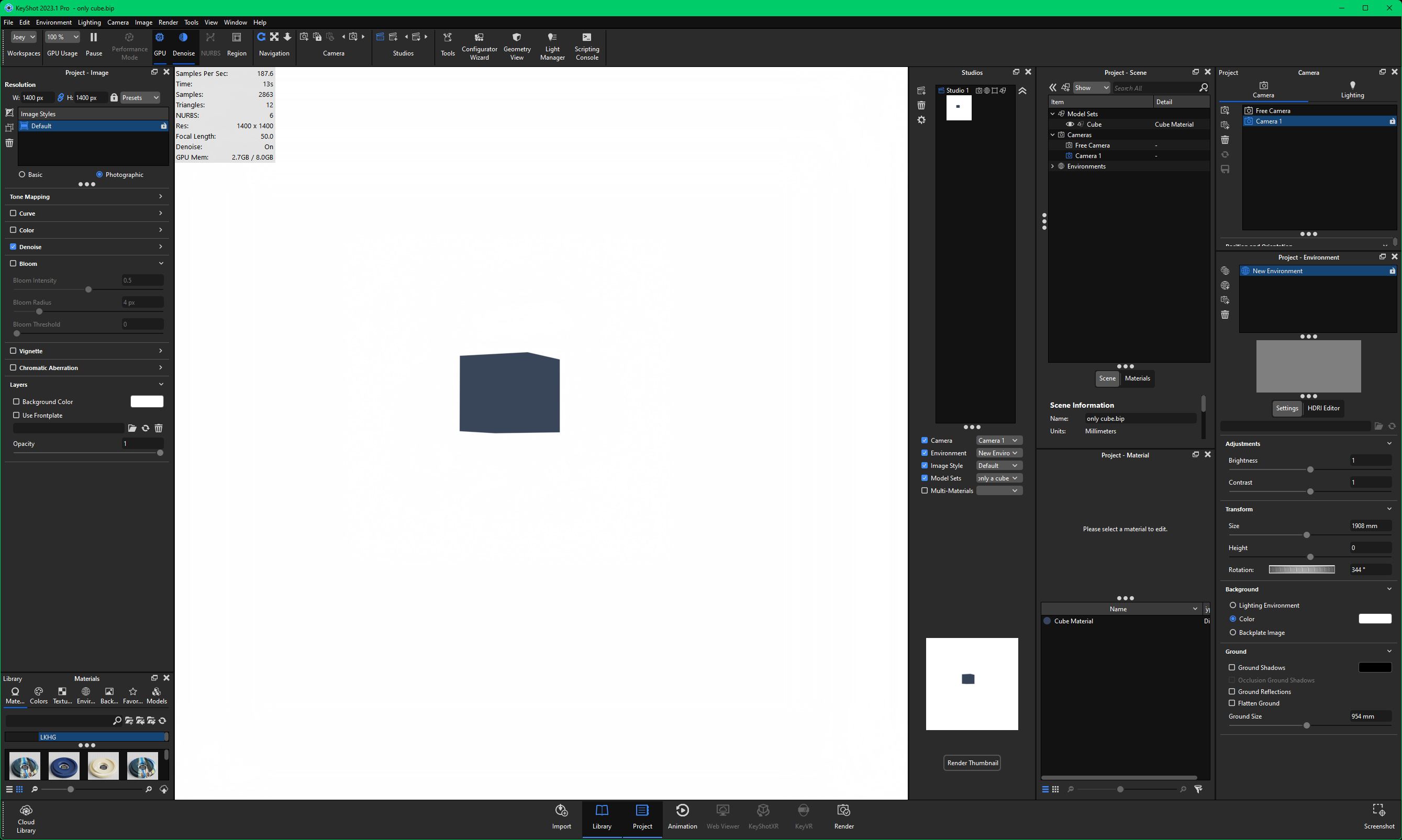

So this file just had this happen tonight, I spent 4 hours trying to salvage it, and I give up. I just deleted EVERYTHING in the file, and left a cube from ‘edit>add geometry’, and added a single studio for it. it’s 1.15gb, and took 5 tries to save. enjoy: https://we.tl/t-4MBx5TA47Q
screenshot showing everything empty:

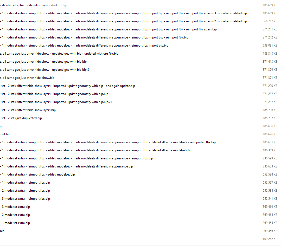

Today I was trying to get the same problems as you had. And there for sure some weird things in how the file can grow but until now I also still got it down to the original size. Which, like you said, didn’t work if you update the model with the .bip but does work if I loaded the original .fbx for some reason.
I’m a bit puzzled why adding model sets actually seem to increase the file size. It doesn’t when you just add a model set, but if you show/hide different parts of that extra model set the file size gets doubled.
In the manual it says a model set is a scene tree variation which in my opinion is always the same model but in a different state with layers hidden or shown or parts moved around. No reason for a file to double the size. It’s also not that consistent and sometimes after it doubles, reimporting the fbx and updating the model does reduce the size again. Odd behaviour.
