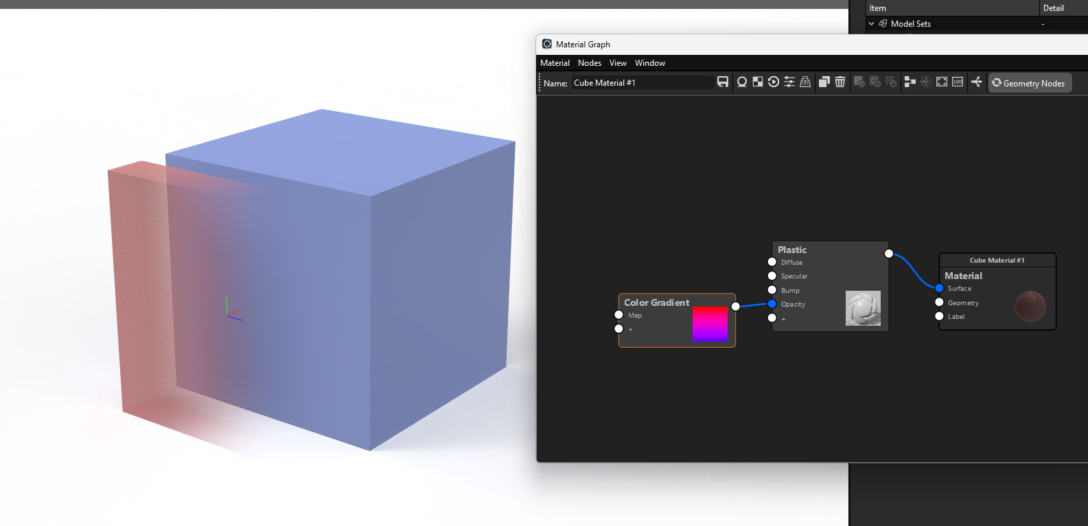

I ran a few tests, and it seems like this behavior may be limited to GPU mode. I tried the animation fade, using a color gradient to drive a fade, and hiding the “front” object as a control. The issue is apparent in the “GPU fade animation image”:
Using a Color Gradient Node didn’t seem to yield the same bug:

Coming back with fresh eyes over the weekend, it seems like the issue didn’t appear when using the material graph to control the opacity, just the “Fade” model/part animation from the wizard. I plugged in a Curve Fade into the opacity and was able to get a result in GPU that was consistent with what CPU was showing:
Seems like this issue can be sidestepped on a per-material basis, but the original bug will still cause issues for hiding and showing groups of objects with different materials. I suppose you could copy and paste a linked Curve Fade animation into every part, but that’s not a real solution for complex assemblies.
