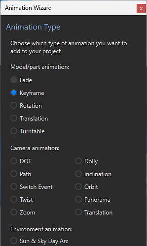

I have a conveyor belt that I would like to animate and perhaps put on some products. The product animation will be easy, but how about animating the rotation/looping of the belt? It consists of many little belt joints (see image). Is it even possible to do? What would be your take on it?

It would be nice to stick to one rendering software to work with, since we are willing to get that realistic look that KeyShot can provide.
I’m thinking out loud now, but would it be possible to use Keyframe feature? The only issue I think we might face is that there are a lot of those little belt parts, so that would be a mess to apply it to every single one of them.
But for the rendering you can just use KeyShot, it’s more that KeyShot is a great renderer but the animation options are quite limited.
If you have a lot of time you could do it with the keyframe animation I think. But for example Blender or MODO etc, basically they repeat that small part over a spline/outline and basically you only need to say how much that spline and its parts should move and it will calculate how much every separate piece should move.
I don’t know blender but looking at that tutorial you can fix it pretty fast, guess blender also exports animations as alembic. In the end those are also all separate keyframes.
If you would do it in KeyShot with keyframes you need to animate every single part of the belt. And it should move exactly same amount over x in every frame also it will collide with another part of the belt. So if you make one error somewhere it’s hard to fix without starting over.
I would really try to copy one of the belt parts in Blender. Than you only need to draw some spline and basically all the other things like copy/paste and motion is calculated by Blender. I’m not a real Blender fan but it’s free and the tutorial looked real simple.
In the end it will all be in KeyShot as keyframes anyway, like you also have after a physics calculation. It’s just the process to animate this manually using keyframes would be a nightmare imo :slight_smile:
